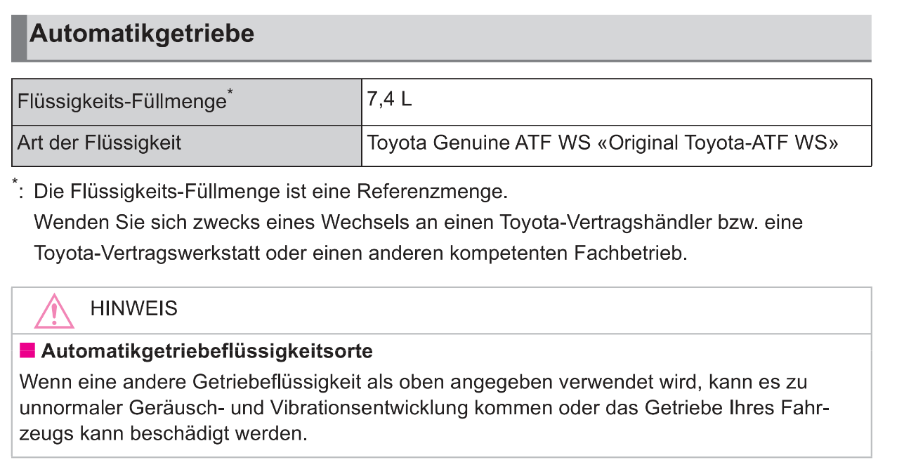

Teilenummer: 08886-81210 (1 Liter)
Hi! For the GR Yaris MK2 with the automatic DAT8 gearbox, the recommended oil is usually Toyota ATF WS (World Standard). The Toyota part number is generally 08886-02305, but please double-check in your manual or with your dealer for your specific model/year. Hope this helps!
